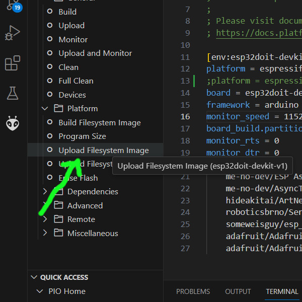

hi andrew,
in addition to the source code, you need to upload the filesystem into the board.
Did you do this?
Otherwise you have to do it using the "upload filesystem image" command from platform IO:
Did you do this?
