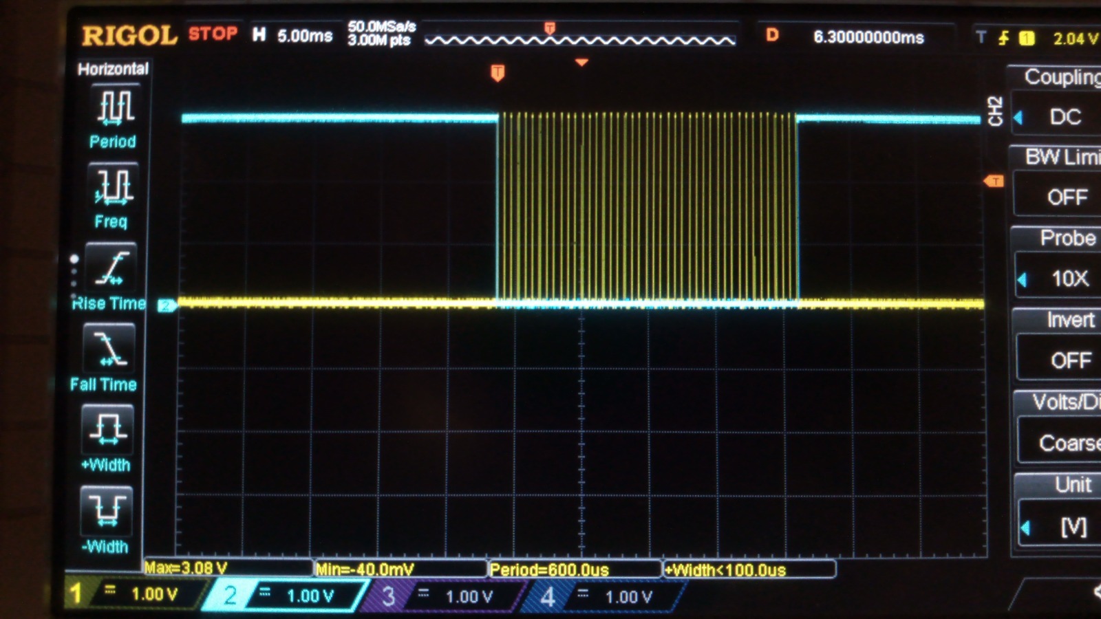

As far as I can see (measure), if the motor is uninverted and the DMX value is ramped up, the dir pin is pulled high every time a step is made (when I ramp up the DMX value really slowly, you can count the individual steps). Between steps, the dir pin is low. What I think is, that if there is not enough time between the dir signal and the pulse signal, the dir pin could still be low (doesn't have enough time to go low and then high again) when the pulse signal comes in, so the motor moves in the wrong direction.
At least, that is my theory.
Messages : 328
Re: Steppermotor moves erratically when DMX value is ramped up slowly
hmm, this behavior is not normal.
The DIR pin should be high or low and only change when there is a change in direction.
I need to do some tests with the oscilloscope, I should be able to do it at the end of the week.

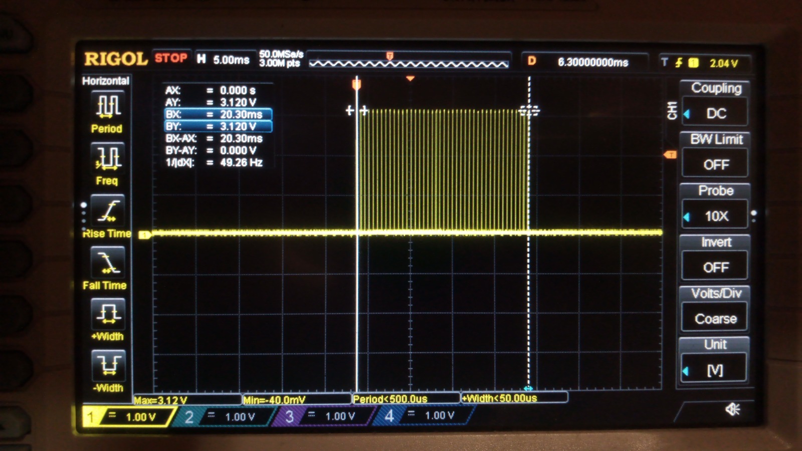

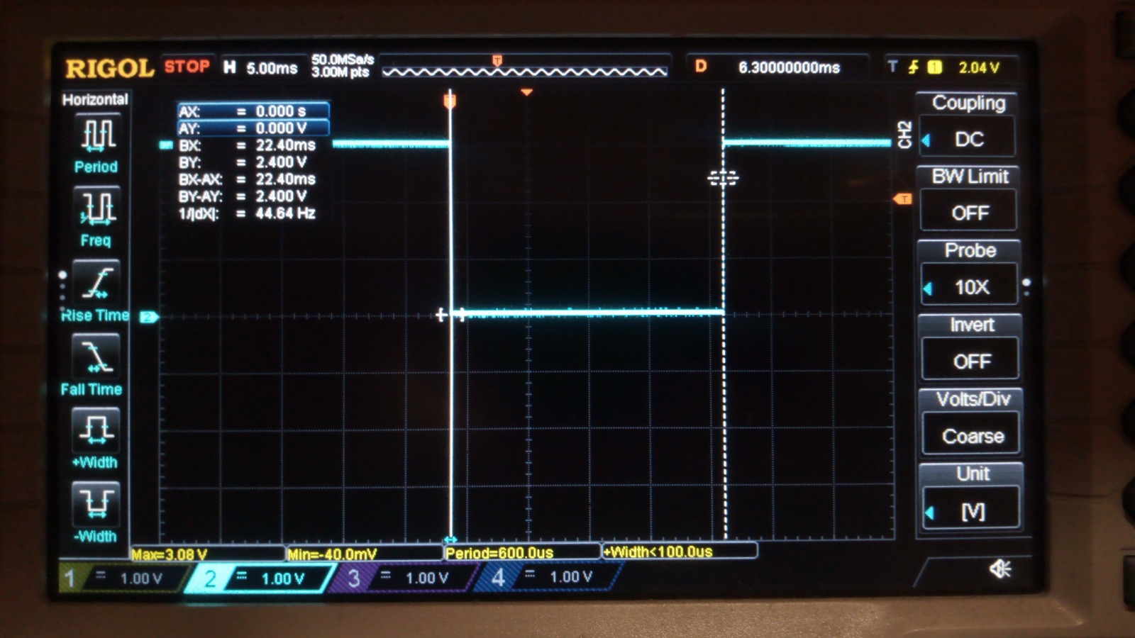

This is what I measure when the motor takes one step forward (DMX value increases by one).
Channel 1 = step pin.
Channel 2 = dir pin.
400 steps/revolution
number of revolutions: 27
